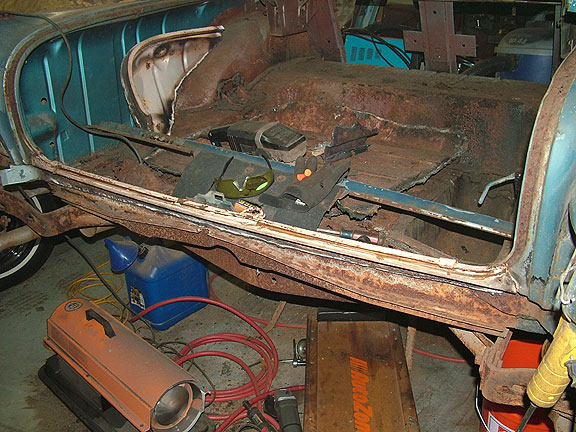

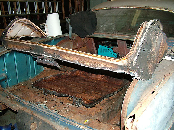

Today, with the help of a fellow BCA member, I harvested the trunk rim and main floor pan out of a 57 Super. Earlier, I had posted a photo of the lip that holds the weatherstripping, and it was virtually gone.
I'll still have to fabricate some of the pan by hand, but this will give me a boost that I need badly.

Hacked and chopped at it some tonight. I had to remove the gas tank before I started....almost forgot to do that. I'm sure the 5 gallons of gas that was in there was in great shape.
Test fitting the channel... I have just a little bit of adjusting to do. After I get that installed, I have to reinstall the metal "skirt" that was welded to the channel. (see photo above). The 57 did not have this skirt.

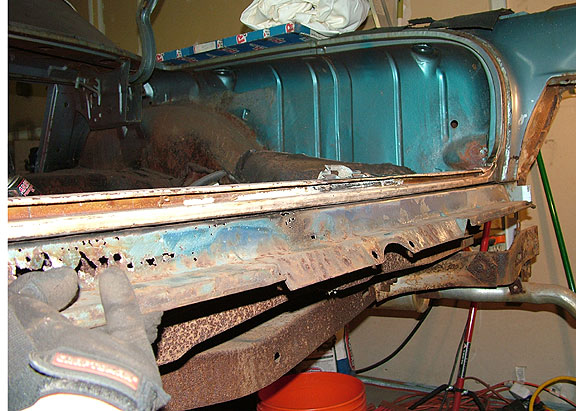

I was hoping I could get away with using the apron I pulled off, but it's more swiss cheese than I thought...and I don't think I can effectively repair it. Does anyone know if all the 58's have this apron that tucks under the rear bumper?
Here I am struggling to hold up the piece while taking a picture - for reference.

I believe all models have that apron. You could probably fix the bad end with a patch panel-it looks pretty flat for the most part.

It does have a slight curve to it, but I may try to patch it. It's much worse than I thought originally. The majority of the left side is pretty ventilated.

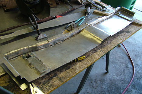

Ok, I hacked at the apron and managed to save it. I had to make the entire left side, basically. It turned out nice. The seam where the apron is welded to the trunk channel gets filled with seam sealer and smoothed, so all you see is a crease.
Look below the apron and check out the rust mess that's hanging there. I completely removed that lower "pan" brace and am in the process of making a new one to replace it. That should be interesting. It also has braces welded into it for the rear two body mounts.
Here's the rear body mount brace...UGLY!! I really got myself into a pickle with this car. This brace was packed with mouse nest fluff, just like the rocker panels.
If I didn't already have almost $2k into the interior already, I'd be seriously thinking about unloading this thing. BUT, that won't be the case at this point.
