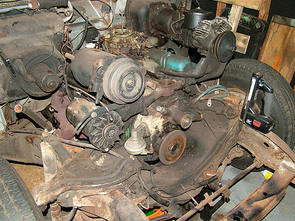

After what seems like forever, I was able to get in the garage today. I rejetted the carburetor for the Centurion and tuned it before I did any work on the 58. I'm close to being happy with that car now:D
I started pulling a few random parts off the engine and cleaned/painted them before I stored them in the basement.
I made some decent progress, although looking at the car as it sits, I've only scratched the "complete" surface.

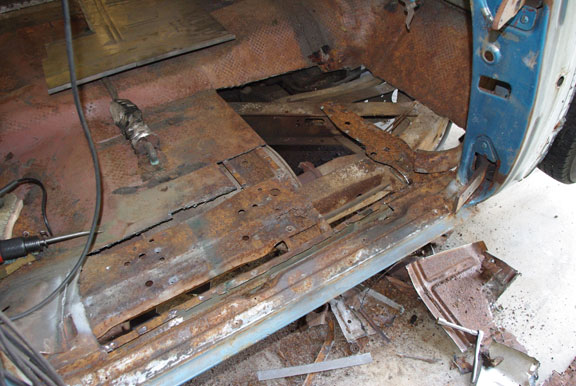

I can't believe it's been almost a month since I posted an update. I've been working some insane hours lately.
I'm trying to get the body ready to come off the frame, so I've been cutting an welding today. I got the rear passenger side rocker panel repaired, but the front is going to be another fun job. I also need to get the passenger side floors repaired. Then I'll be ready to pull it off the frame.

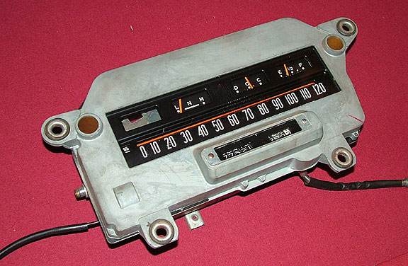

I forgot to post a photo of my speedometer that I cleaned up and put together from my last update:

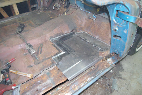

I was selfish today and turned off my phone so I could work in the garage...
I tackled the front passenger floor. I also removed my first attempt at welding
...it wasn't pretty.
I didn't get finished with it, but I made some good progress.
