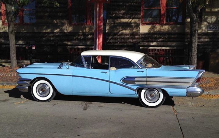

well, here we go, finally got some new tires. these are 760-15 BF Goodrich 3 3/8" whitewall bias-ply tires from Coker. really completes the look! :D

Nice! New tires make such a difference. I just got new ones from Coker for my 60. Night and day difference from the crappy brown walls I had before.
