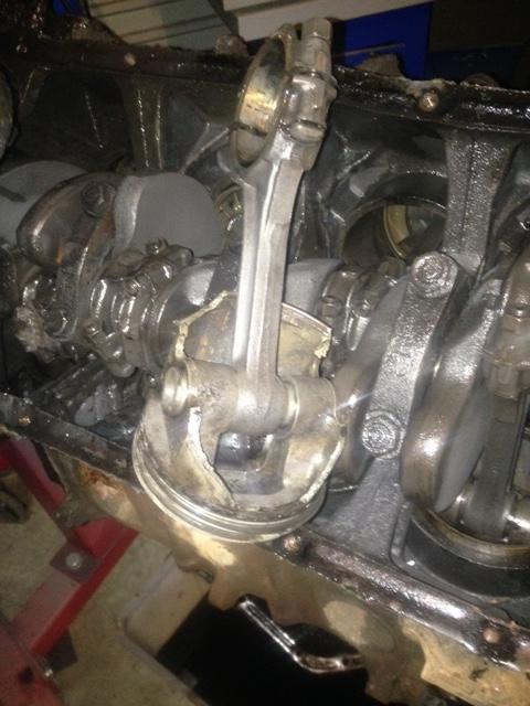

New on here, but I have just (a couple of weeks ago now) freed up the engine in my car and got it to run
Sounds very similar to yours, water about the place, I think mine had been left outside without an air cleaner on it?
Anyway, I used wd40 and trans fluid and patience (2 weeks of soaking and trying to move it every day)
The day I got it to turn, I had a 3/4" drive bar with an extension pole for more leverage and the starter hooked up through 24v and a jump wire to activate the starter all in action
Basically, while pulling down on the bar (tightening the crank bolt) I would activate the starter and it would clunk in and with a meter and a half of leverage, it would move about 1mm
After a couple of hours of doing this (letting the starter cool) it slowly started to get better until the extra leverage was not needed
This killed the starter (no biggy, the starter for an international is exactly the same except for the drive end housing (pinion ect all the same)
Once it was turning ok (and I fitted a new starter), just cleaned the points and away it went, but it knocked
Engine is now out of the car and in pieces, the knock is #1 piston broke its skirt , not sure when, but it looks like a while ago
