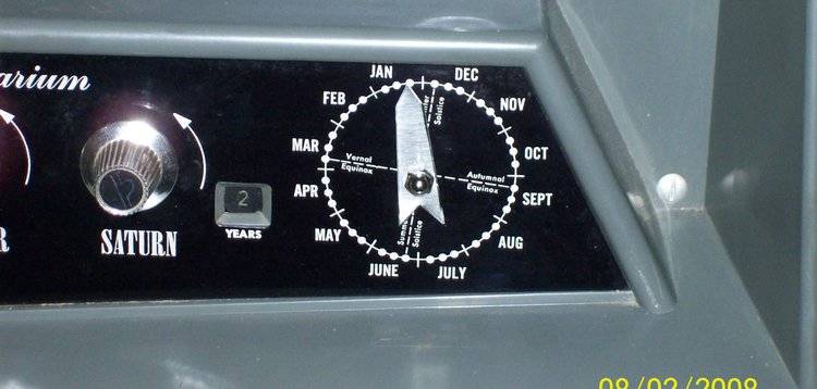

Below is a close up of the control panel. To the right of the Saturn knob is a window with a number - this is the elapsed time, in earth years. When the motor is turned on, the planets begin to orbit. Every time the Earth makes one revolution, the number advances one year. The indicator at the right shows the months, vernal equinox, autumnal equinox, summer solstice, and the winter solstice. The needle was missing but I had a new one made out of stainless steel. It is very similar to the original, I had a photo another owner sent to me to use as a guide. The photo was from an angle, so the dimensions of my new one might not be exactly correct. In the photo below, the needle didn't show up very well. It is flat and the edges are smooth, despite the appearance in the picture.

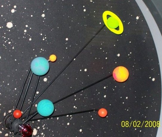

The planets are driven by a motor and ball-chain/pulley system. The ball-chains look like the chains used to secure pens at the bank and other places. The chain that drives Mercury is loose, there is no adjustment so I'm going to have to make a tension bar to take up the slack - Mercury is not rotating properly with the loose chain. Next pictures are close-ups of the planets. The flourescent paint was peeling and you can see two little cracks in the center of the 1/16" thick plexiglass cover by the "Sun" light. There was another large 3" crack at the lower left side of the cover - not seen in this photo. I ordered several sets of flourescent paints, but they were all exactly the same, and the newer paints are different than the old original paints. For instance, the yellow has a greenish tint that the original didn't have. I took a few liberties by slightly modifying the colors of the planets when I repainted them. Note: despite its appearance in the photo on the right, Jupitar does not have a purple spot on it. It is a photo artifact.

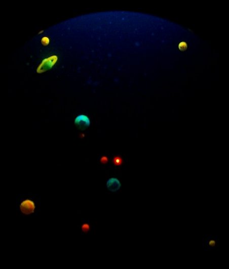

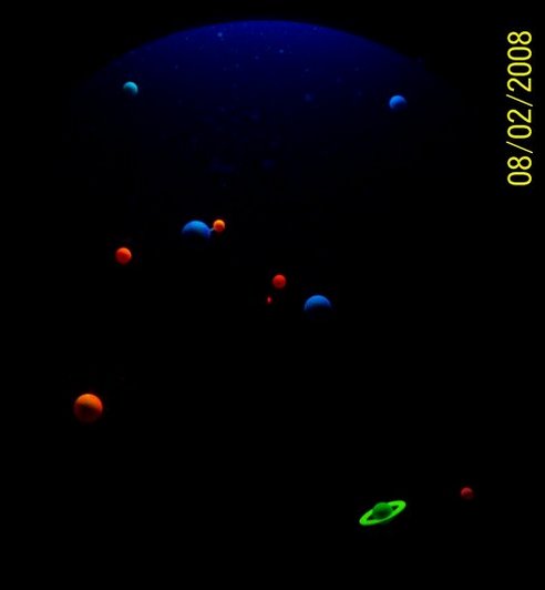

Next is a picture of the flourescent effect in a darkened room. This is really stunning in person. The red light in the center represents the Sun.

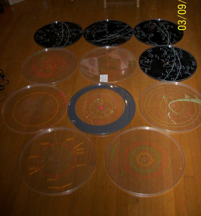

Below is the data plate, showing serial number 515, and eleven of the overlay disks. These are about 16" in diameter. I have a few more: three blanks ones, and two that are supposed to be motorized, but they are missing parts. I also have two duplicate constellation disks: February and April. There are supposed to be 12 of these - one for each month. I only have January through April. If anyone wants to trade for my two spares, please contact me.
