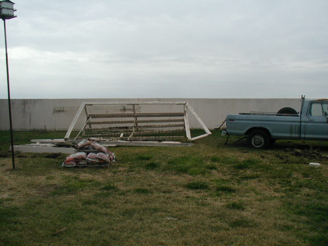

Tearing down the old deck.

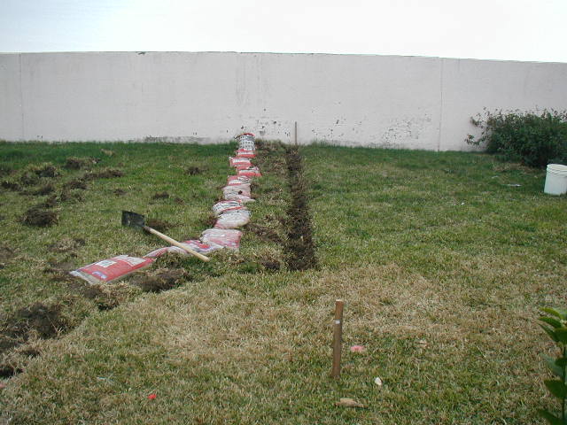

Digging base for retaining wall.

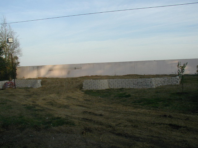

Retaining wall mostly complete. Five loads of fill dirt and counting....

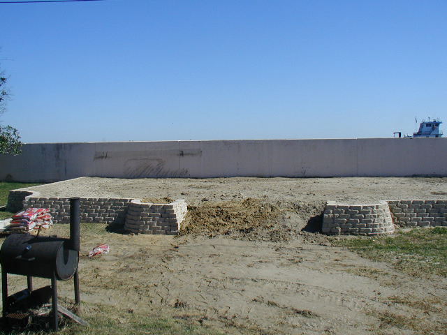

Retaining wall complete except for steps in the open section. Eight loads of fill dirt were required. Actually, I'll need a little more dirt, but I'm going to let this settle for awhile before bringing more dirt in. The dirt was packed with a tractor, but it always seems to settle a little more after a few rain storms.

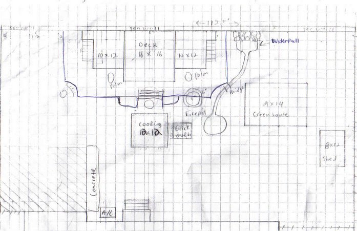

The plan. Rough and corrected several times, but you get the idea.
